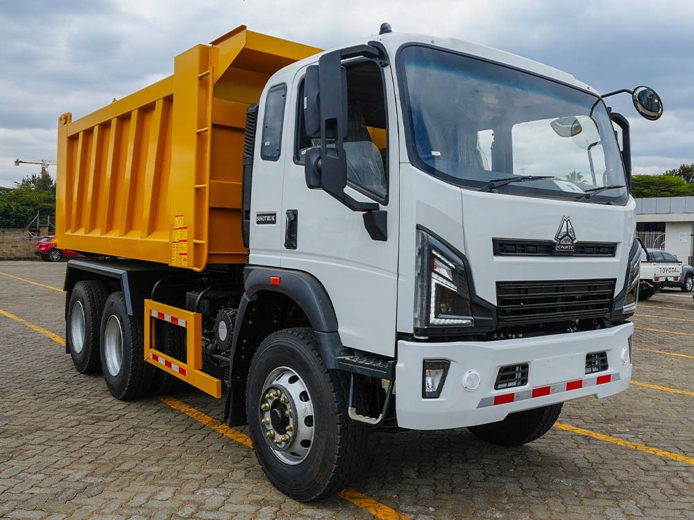

The Howo H3 Tipper Load (16 tonne) is a robust 6x4 heavy-duty dump truck produced and marketed by Sinotruk. Its entry into the African market, or even the Kenyan market for that matter, is already giving the likes of FAW Jiefang, Isuzu F-Series, Tata Prima, Ashok Leyland Ecomet, and Mercedes-Benz Actros a run for their money. The H3 Tipper offers a striking balance between payload capacity and maneuverability compared to the heavy-duty tippers. It makes an excellent choice for individuals or businesses looking for a reliable, affordable, good engine torque, and a high payload capacity.

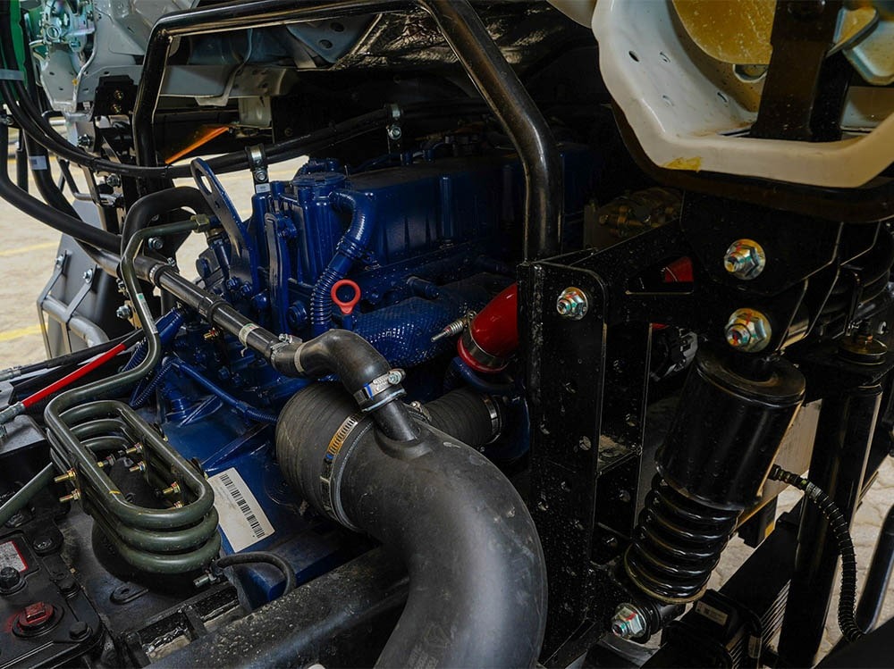

The Sinotruck Howo H3 Tipper comes with a single engine option. A WP4.6NQ220A 4580cc inline-four Diesel churning out 220 horsepower at 2,300 RPM and 800 NM of torque at 1200-1800 RPM.
READ ALSO: Sinotruck Howo H3
Howo H3 Tipper

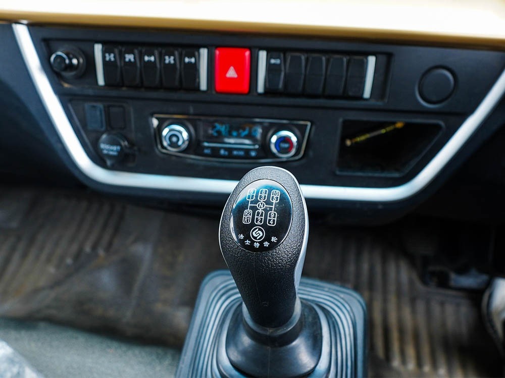

This powertrain is connected to a 10-speed manual transmission with 2 reverse gears.
Maximum speed is 80km/h
